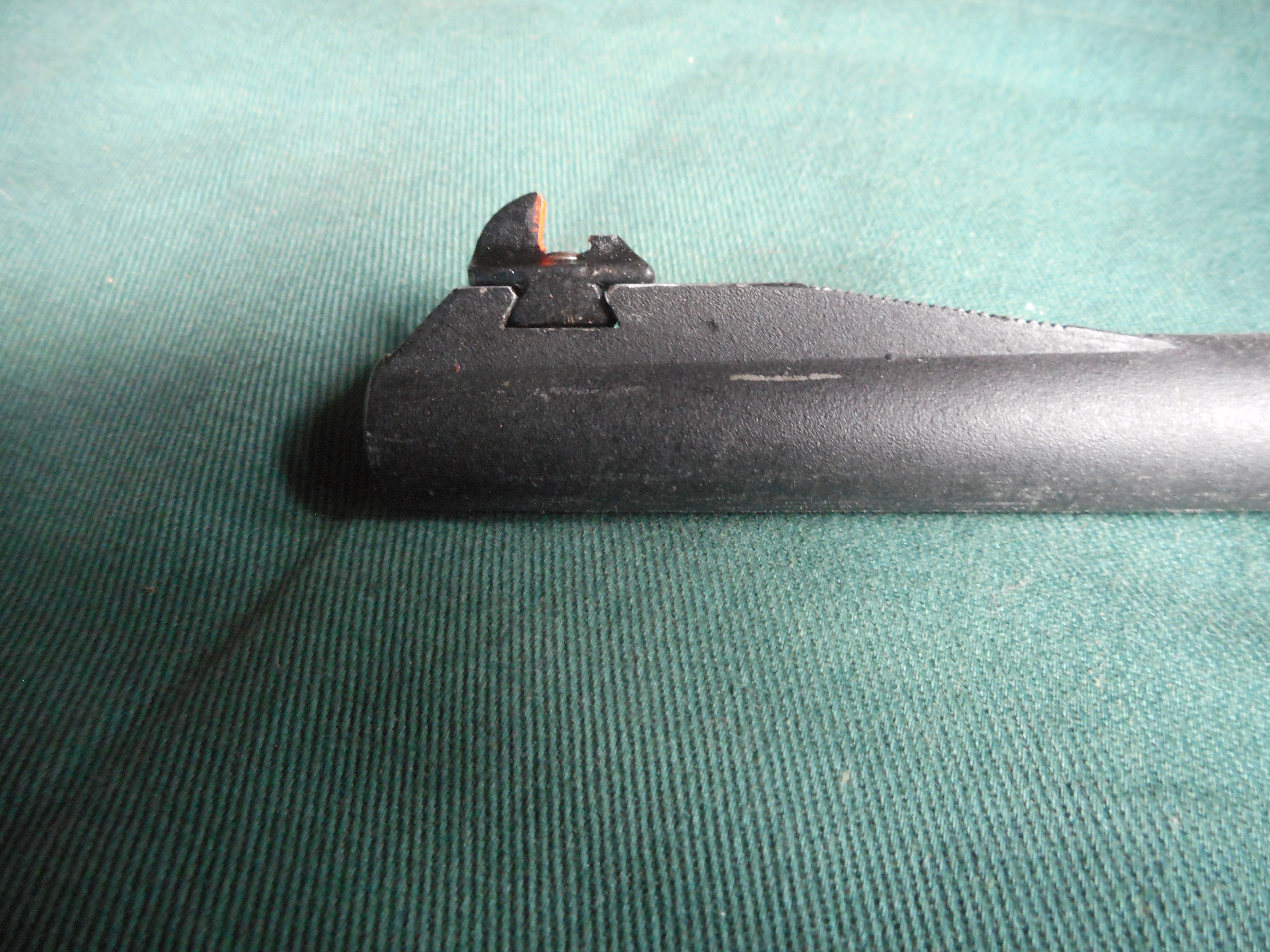

Hold Down Screw Mod, Witness Marks and Fluorescent Orange Paint.
Since the AR-7 is a “survival rifle”, it seems to me that the front sight should be protected in some way from getting moved around. You would have thought that Gene and the Armalite Boys would have come up with something. Anyway, some of the front sights on the AR-7 are so loose, they move on their own or with just a gentle touch of a finger. To protect the front sight, I thought of installing a removable sight hood, as can be found on the Mauser K98, but it’s too large and will not fit in the stock. I thought of adding a couple of “wings” but couldn’t come up with a way to easily attach them. So I settled for a simple allen head set screw to hold the sight in place.
PROCEDURE:
I am working with the aluminum front sight from the Charter Arms AR-7, but this will work just as well with the plastic front sights on the HRA version. Remove the front sight blade from the rifle. Making sure not to cut through the tallest part of the sight blade, with the Dremel tool and cut off discs, or other appropriate saw and files, cut a 5/32” gap from the top to the bottom of the sight blade. At the center of this gap, drill a 9/64” hole completely through the base of the sight. Using an 8-32 Tap, thread the hole completely through. Insert an 8-32 X 1/4" allen head set-screw. To lock the sight into place when the sight is installed on the rifle, simply tighten the allen set-screw.
I ground down the remaining rear portion of the rear sight blade leaving about 1/8”+/-. I painted the back of what remains of the front portion of the blade with some fluorescent orange paint.
Now when I look through the rear sight of my AR-7 I see a bright orange sight post having a nice flat top.
To create witness marks to be used as a reference after you have zeroed your rifle, I used a silver Sharpie marker and covered the rear part of the base of the sight with silver. I also put a bit of silver in a corresponding location on the top of the of the sight base on the barrel. Once I adjusted the windage of my AR-7, I scratch a straight line (the “witness mark”) on the two patches of silver, so I can return the sight to its zeroed position should it ever get knocked out of place. If you need to re-zero your AR-7 for any reason, almost any solvent will remove the silver so you can re-apply it and make new witness marks.
FWIW: I see that front sights for the AR-7 can be bought in a molded in a very bright day-glow orange. I think these sights fairly scream “HERE I AM!” and are somewhat inappropriate on a “survival rifle”, but to each their own.

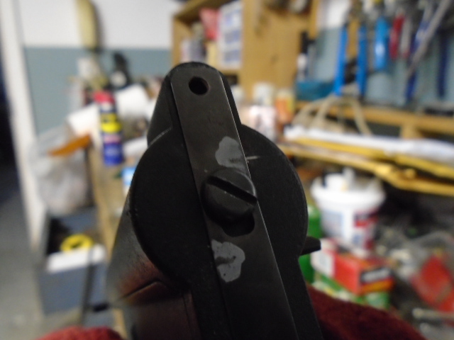

You would think this is the simplest modification you’ll ever do, but the devil is in the details. Because I was drilling a new hole in the CA rear sight, I had to very carefully locate my center punch not only left and right, but also locate it the same distance from the center of the sight blade as the hole on the opposite side. This was necessary so that the elevation and windage adjustment of the front sight would remain constant and not require re-zeroing every time I changed rear sights.
If you are modifying a Henry rear sight, just go ahead and drill through one of the existing holes. That hole will center the drill bit as you go. If you would like a set of sights with 4 apertures like I have, buy a rear sight from Henry Arms, drill the largest hole on one of them to 1/8” (or whatever) and drill the smaller hole to 1/16”.
As above, I used a silver Sharpie marker to create a silver spot on the sight blades to scratch in a witness mark. You should zero and put a witness mark on ALL of the apertures, that way you would be able to change apertures in the field should lighting conditions permit. I find it useful to zero my sights out to 100 yards and put on a smaller witness mark, so I can adjust my sight to deal with different distances, 25 yards and 100 yards. On the receiver, about ¾” from the top of the rear sight hood, using a modeler’s saw, I cut a datum line on the right side of the rear of the receiver for a more permanent mark.
Just to show how intricate aperture sights can be I've included this last bit of trivia. On the left is the modified Charter Arms rear sight. The one in the middle is an unmodified Henry rear sight. The one on the right is a Parker Hale target sight mounted with a Parker Hale eyepiece having 6 apertures on a rotating disc. The apertures range in size from .03 to .08.
