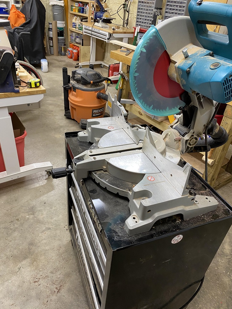

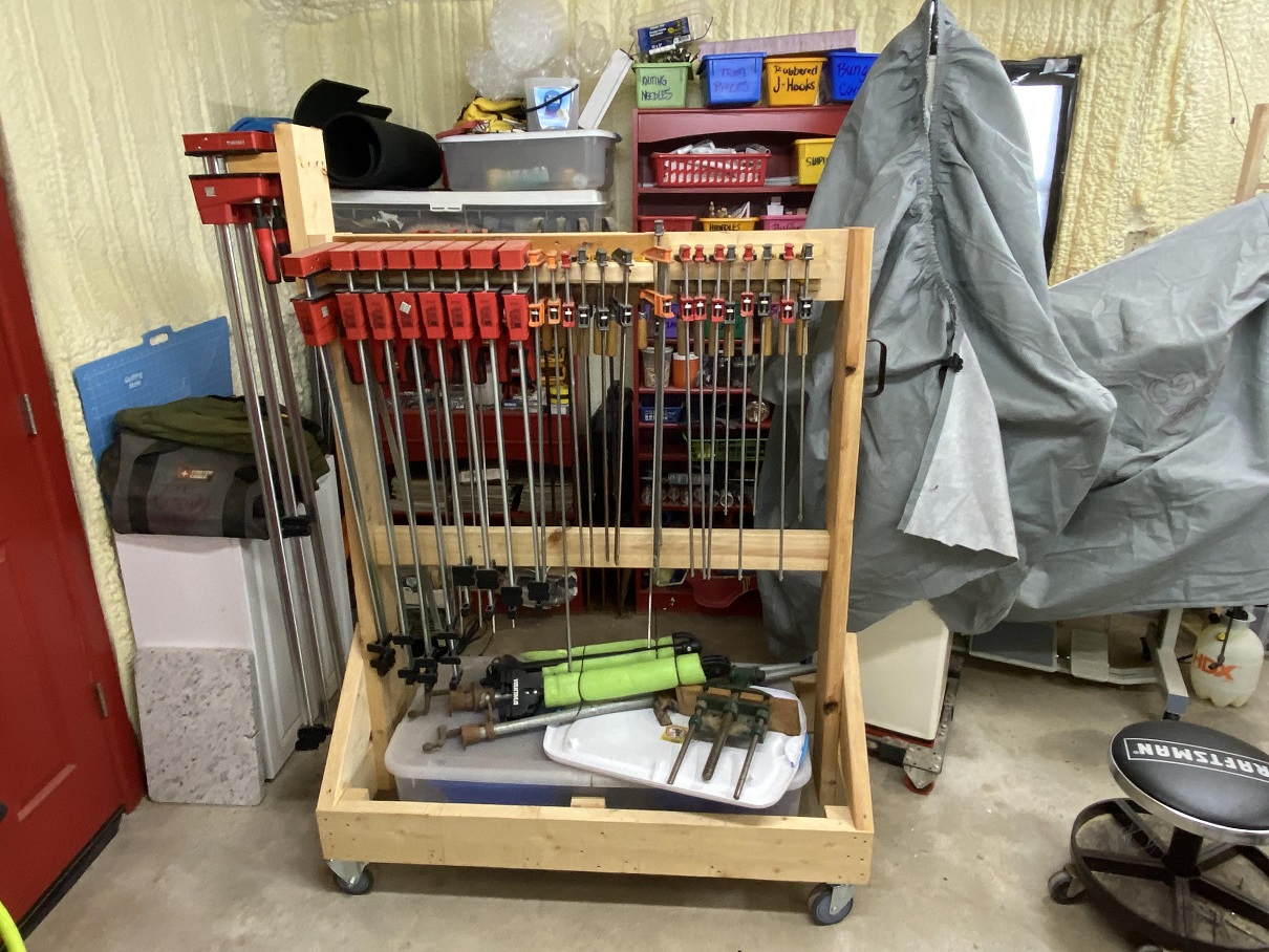

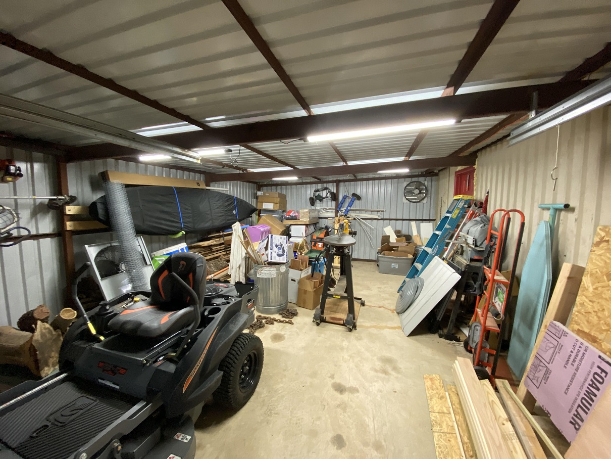

Headed out to the shop this morning to work on the kitchen range cabinet project. First things first, had to get set up to start the actual cutting and assembly. You have all heard me refer to equipment stored in the "boathouse." I'm sure some of you wonder "Where is this boathouse?" You have seen the red door at the back left of the woodshop... it's the entry to the boathouse from the woodshop. HERE is a look inside the mysterious boathouse.
The red door is visible at the right rear of the boathouse. We have always called this the boathouse because when we first moved here, the kayak trailer and two kayaks were also stored here until we added the new barn and they were moved into a stall in the old bard and CHAINED to the wall there. There is still a kayak hanging on the wall here. I also store NON climate sensitive equipment and tools here, and I have wood stacked against the left wall. OFF the floor on blocks Slab size, 2' x 12' some of it. New project stacks, like the oak and poplar for the project today.
I also had to get the clamp rack and roll it into the shop as I'll need a number of them in this stage of the project.
In addition, I set up the Miter saw, and the vacuum, I'll be making a number of cuts to prep for assembly. The cuts will come from the last sketch and I'll temporarily assemble the project to check the lengths before proceeding. Oh, I'll need more space for assembly than the regular woodworking bench, so I cleaned off the cutting table and the knife shaping table and adjusted their height so they matched.
- 11 miter saw set up.jpg (358.52 KiB) Viewed 4692 times

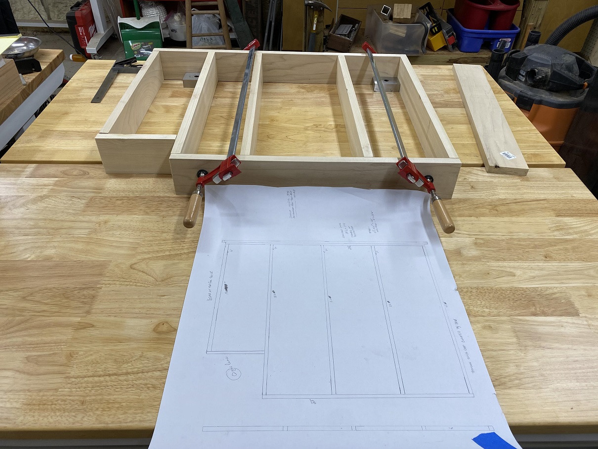

Working from the sketch, I made each cut, measuring carefully and cutting to, but leaving the fine pencil mark to insure accurate length. Once all the pieces were cut, I began a rough assembly to check the fit and length of the pieces. I didn't worry about spacing of the interior shelves at this point, just that the layout was square to check for the measurements. The drawn concept has become physical reality.
Look carefully inside the shelving, what are those silver things? Oh, yeah... the 123 blocks have once again made their appearance. They are heavy, so they stay in place. They are machined to perfect 90 degree corners, so I can use them to assure the layout is square. No going corner to corner with the tri-square and trying to move one corner and pulling another out. This is just a test, no glue, no fasteners in place.
I will come back out and run each component across the table saw to rip them to width. Once done, I'll reassemble them and began spacing the shelves and marking the sides. Once done, the holes for assembly can be drilled, and the notches for the dowels can be cut. We will make progress. The base and the walnut counter top will be next for this side. I'll cut the oak face last.
