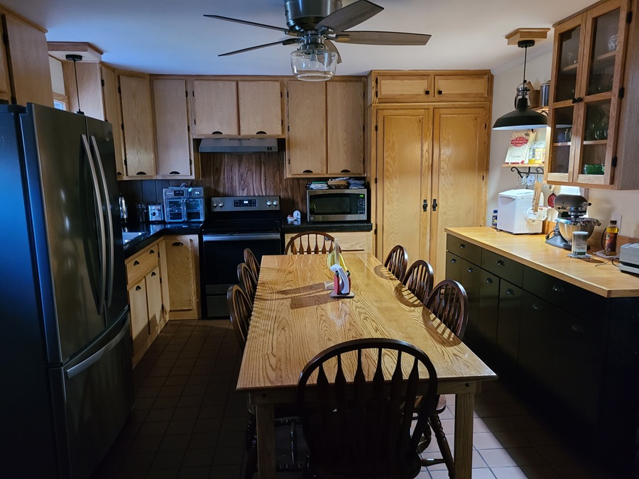

I built all the cabinets from birch, the farm table is red oak, the chairs were made from maple, countertop by the sink is concrete, the floor is 6"x6" quarry tile. The fridge used to set where the pantry is now.

Was the concrete counter top difficult?

Not really it is all about the mix and proper water amounts. I also covered the forms on the inside with water-based poly and sprayed them with pam. They came off without a hitch also, tapping the form all around ensures the concrete fills the forms without any holidays. I used a colored epoxy after 30 days of curing.
