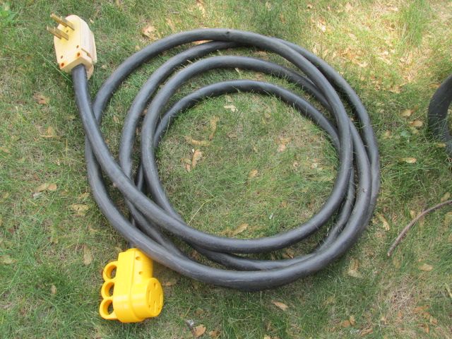

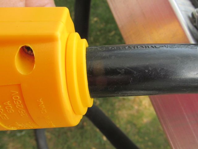

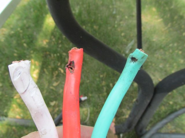

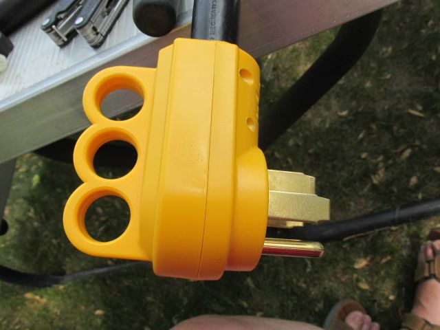

installing 50 amp RV replacement plugs isn't a highly technical task but it can take some effort and be a bit frustrating .... it involves connecting 4 stiff copper wires to terminals in a very confined space .... while the instructions do help, they don't include info several tricks that make it a bit simpler .... as seen below the plastic plugs can and do break and 50 amp cords can and do suffer damage .... temporary patches like the one in blue don't keep out water and for me that is a concern .... my preference is to cut the cord and install an appropriate male/female plug .... by doing so I have a couple of shorter cords that can easily be connected when needed

I like the brass knuks gripper on the new cord end.

they sure do make plug'n and unplug'n easier
