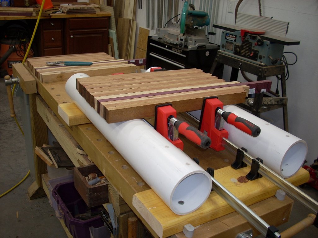

In case, dear reader, you didn't see the "Small Projects" post, I will be using the PVC work stand in this project. It was made especially for glue up of the cutting boards. Here is a mock up of the stand in use. It allows for smooth glue up and then clamping...
34 pvc rack.jpg (166.93 KiB) Viewed 4476 times
35 side view.jpg (153.7 KiB) Viewed 4476 times
The board components on the stand are the ones I intend to use, but they had not yet been planed. The main component show is the exotic from the Caribbean. The name escapes me, but I will make the two boards from these slices from the table top and present them to my Friend and his son as a memorial of the Father and Grandfather, pilot of a bomber in WWII and a good role model all their lives. He is living in a home these days, but still sharp as a tack and recently interviewed and video taped so his memories of a critical mission during the war could be forever kept and used at the WWII Museum. If you visit, Dave's Dad narrates the harrowing mission where is gunner had his foot shot off and still completed the mission. As Pilot in Command he recommended the Gunner for the Silver Star, which he received.

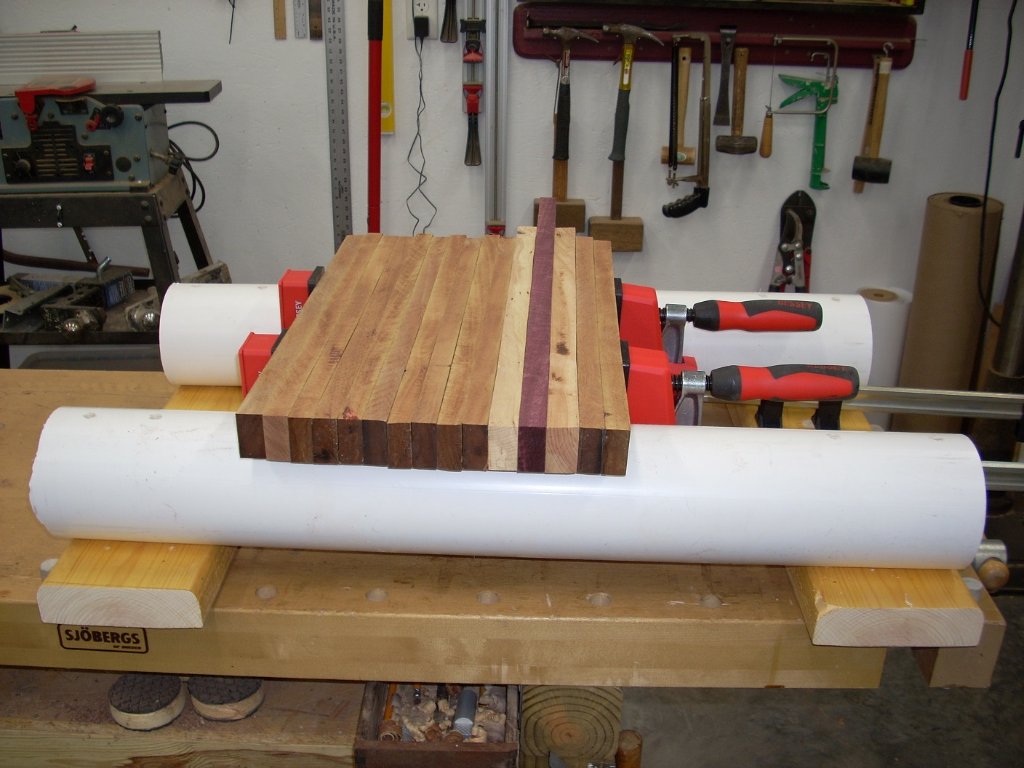

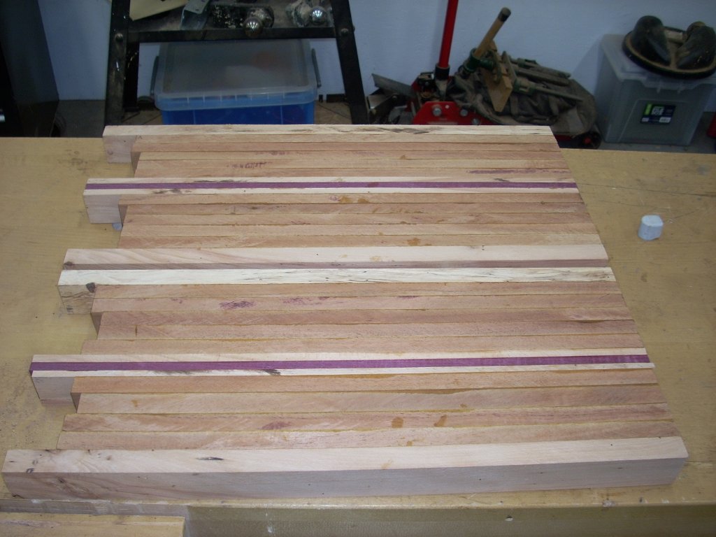

This morning I headed out to do the glue up. A chance to try the new jig and see if it was worth the effort. Clamped it on the bench and laid out the first cutting board. You leave the nearest piece standing and lay each of the others flat turning them back away from you. Then you glue the side facing up and turn each one to the board in front, rebuilding your cutting board.
41 laid out for glue up.jpg (154.03 KiB) Viewed 4463 times
There are a number of ways to apply the glue, and I have tried several, seeing many options in the video. I finally found the one that works the best and would you believe it is a properly sized paint roller. Once it soaks up enough glue that it doesn't suck up anymore, it's a dream for application. Even and smooth and quick. You squirt the glue directly on the board and then spread it evenly with the roller. Place the board then repeat.
42 would you believe a paint roller.jpg (131.87 KiB) Viewed 4463 times
Careful application of the glue reduces the mess, and makes for a smooth even job. Once all the glue is applied you clamp up the project and set is aside to dry.

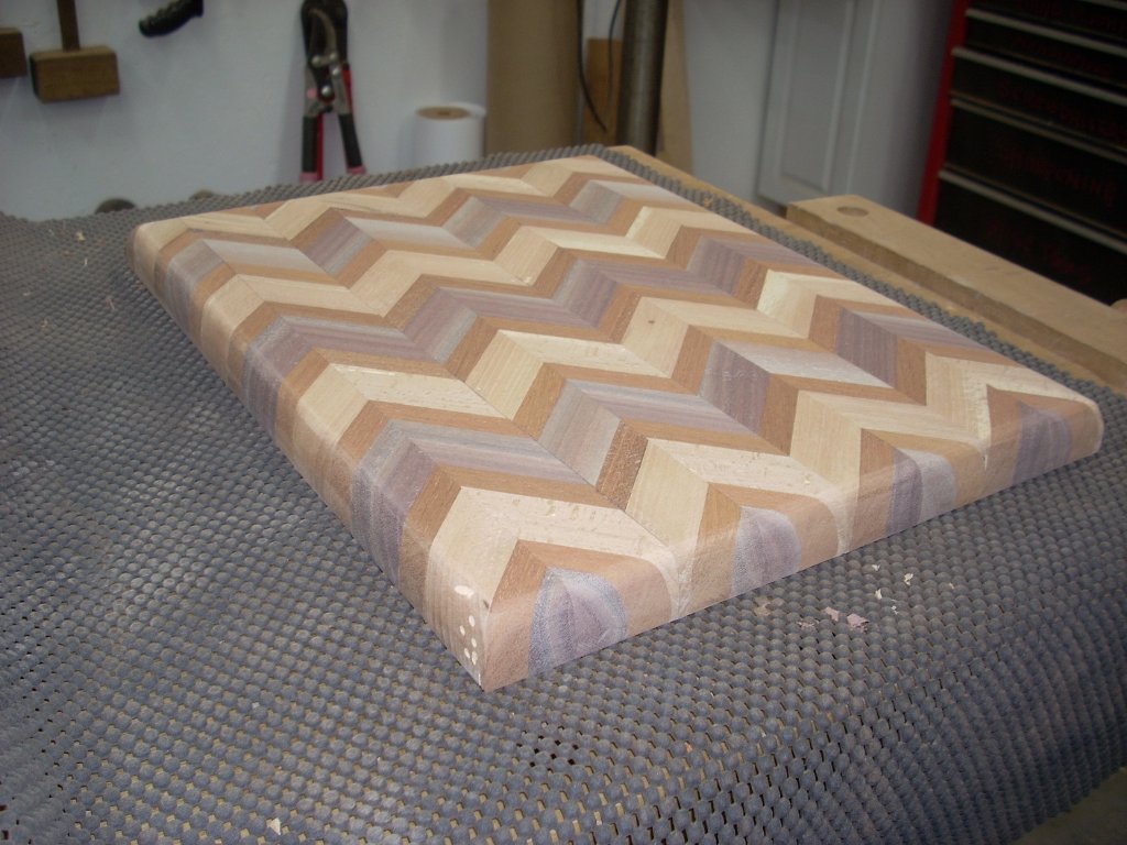

Here is a closer look at the pattern as clamped. Once the board is set up, it will have the edges trimmed and then be scraped to remove excess glue and run thru the planer and sanded to 320 or 400.
44 closer look.jpg (209.01 KiB) Viewed 4463 times

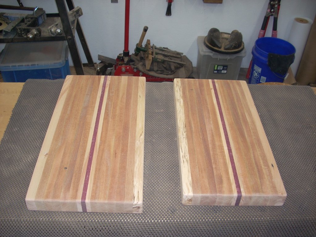

Put the two rough cutting boards thru the planer, to shave off the old glue and then get two flat sides, removing the slight imperfections. A lot less than in the last four practice boards since I had my pvc rack to assemble them on and the GOOD clamps.
47 rough cutting boards.jpg (153.9 KiB) Viewed 4437 times
After they were planed smooth, I put them in the SLED I built to allow for this operation and trimmed both ends square. This would not have been possible without the sled. The miter bar would not have been deep enough to allow the width of the cutting board to fit nor strong enough to handle the weight.
48 Sled ride.jpg (125.45 KiB) Viewed 4437 times
49 one planed.jpg (127.36 KiB) Viewed 4437 times
50 second planed.jpg (144.91 KiB) Viewed 4437 times
Once both were trimmed, I used the 1/4" roundover bit in the hand held router to round the top edge of both cutting boards then switched to the orbital sander and smoothed the tops, sides and the bottom to 120 grit, rolling the edges and the corners at this grit. I took my time and made sure it all looked good. Next I upped to 220 and worked the edges and top again and the result was a surface like high quality glass. I wish you could feel it.
51 sanded to 220.jpg (183.24 KiB) Viewed 4437 times

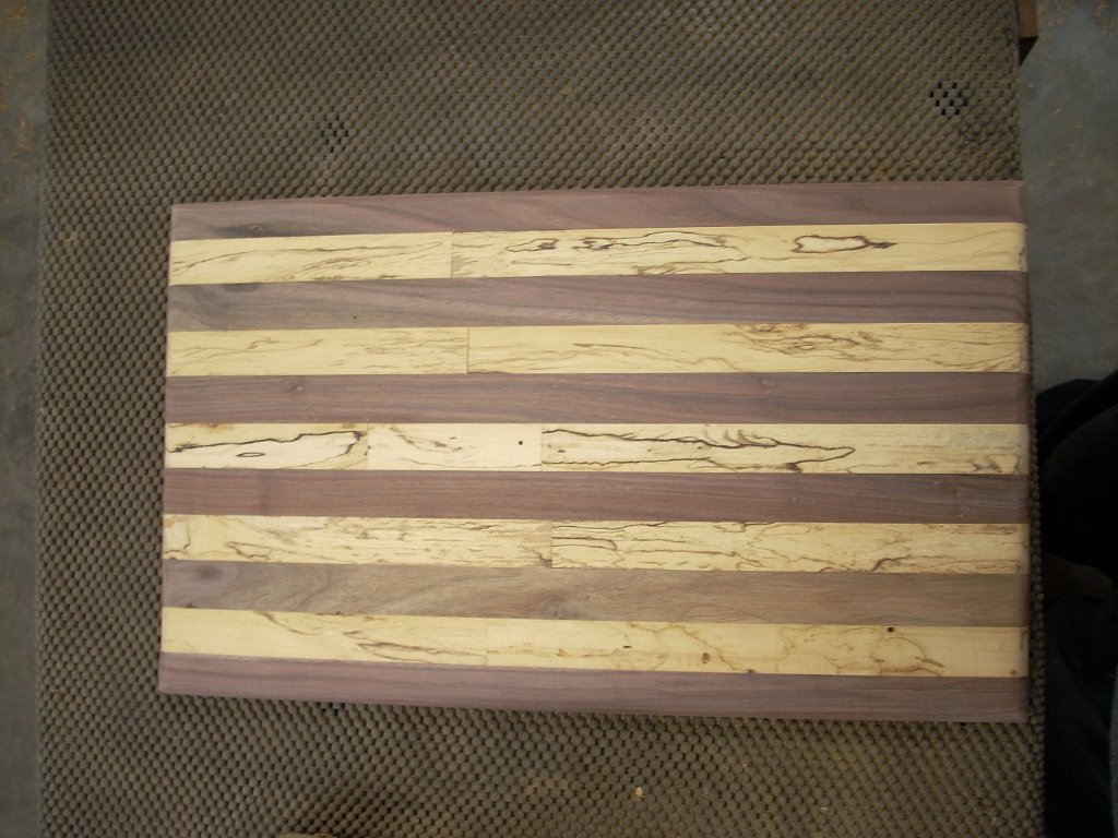

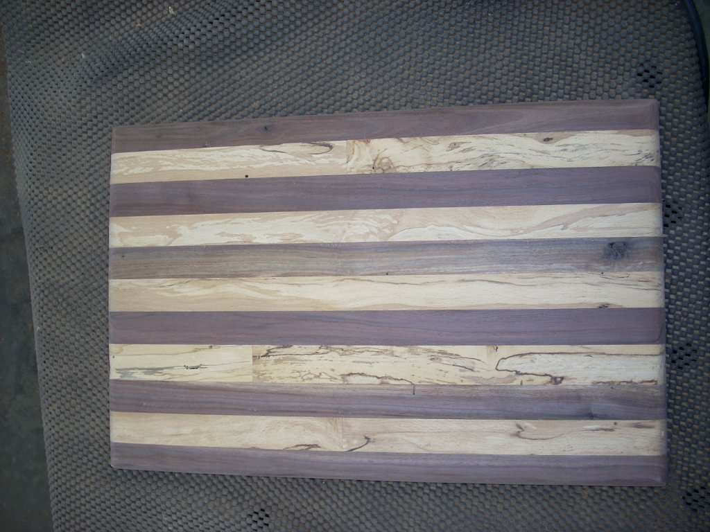

Worked on the walnut cutting boards as well. They had their edges dressed up and the scratches from that old nasty router table removed. The edge beading was removed with a plane, and I ran them thru the planer a and shaved just enough off the top to remove the scratches. Then 120/220 for these as well. Boards one and two are done, three is clamped regluing a loose joint.
56 walnut one.jpg (184.14 KiB) Viewed 4421 times
57 walnut two.jpg (179.41 KiB) Viewed 4421 times
