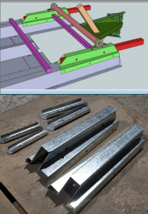

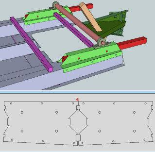

And what does one do on New Year's Eve? One designs car parts of course and prepares them for laser cutting tomorrow (yes, New Year's Day).
The chassis piggyback sections to be exact (bright green), that accept the rear bumper/trailer hitch, support the rear swingarm pivots, and has the fuel tank rear cross member integral as well.
Finish my New Year's 18 year old Glenlivet whiskey, and off to bed
Good morning from 2024 ... 12:40 am to be exact.

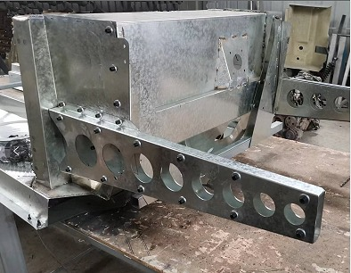

Everything for the 'piggybacks', as I have decided to name them, went well today.
The other 4 bits are load distributors for the swingarm bearing mounts.

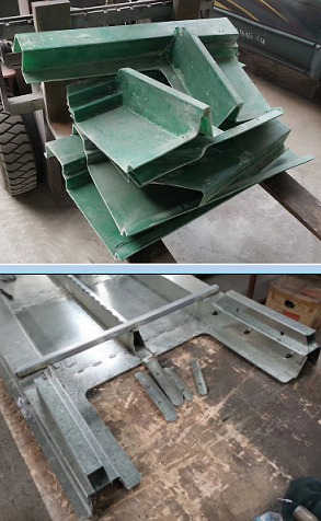

Out with the old, in with the new ... I was a little despondent cutting up the fiberglass floor and putting it in the rubbish.
With these builds you need to plan 10 steps ahead, what you design today, might not be right 10 steps later, and I have hit roadblocks a few times, but believed this was it ... I should have planned 11 steps ahead ...
Was a cruel blow to be so confident, make a pattern, then the mold, then the part, of course this took time and money, now all 3 are rubbish due to one single thing I didn't foresee ...
But anyway, moving forward again, but I will complete this one, which I do believe is the absolute final one, entirely in steel, in case I did miss another 11th step because I don't want to go through the pattern/mold/part process and have it fail all over again.
The pictures are, fiberglass floor cut up, piggybacks for tow hitch on, and front engine rails on.

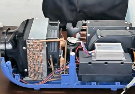

Phones aren't important to me, but I do use them to take snaps to upload pictures here, but because not important, I often forget to take it with me, so no snaps of the mounted rear suspension swingarm today ...
I believe I have found a niche market small airconditioning company to do the aircons, a headache I foresee coming.

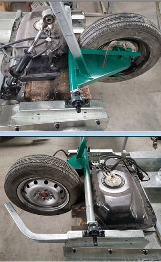

Lining up the rear suspension, fuel tank, tow bar ect.
Just a piece of scrap bent square tube in the lower picture to show the basics of how the rear bumber/towbar will work.
Swingarm bearings are just stock pillow block bearings from any bearing shop, and cheap, as is the 20mm threaded rod (not trimmed to length).
But I now have to go away for a week for some business investigation, related to the BEX, but don't cry for me Marge or Tina.
