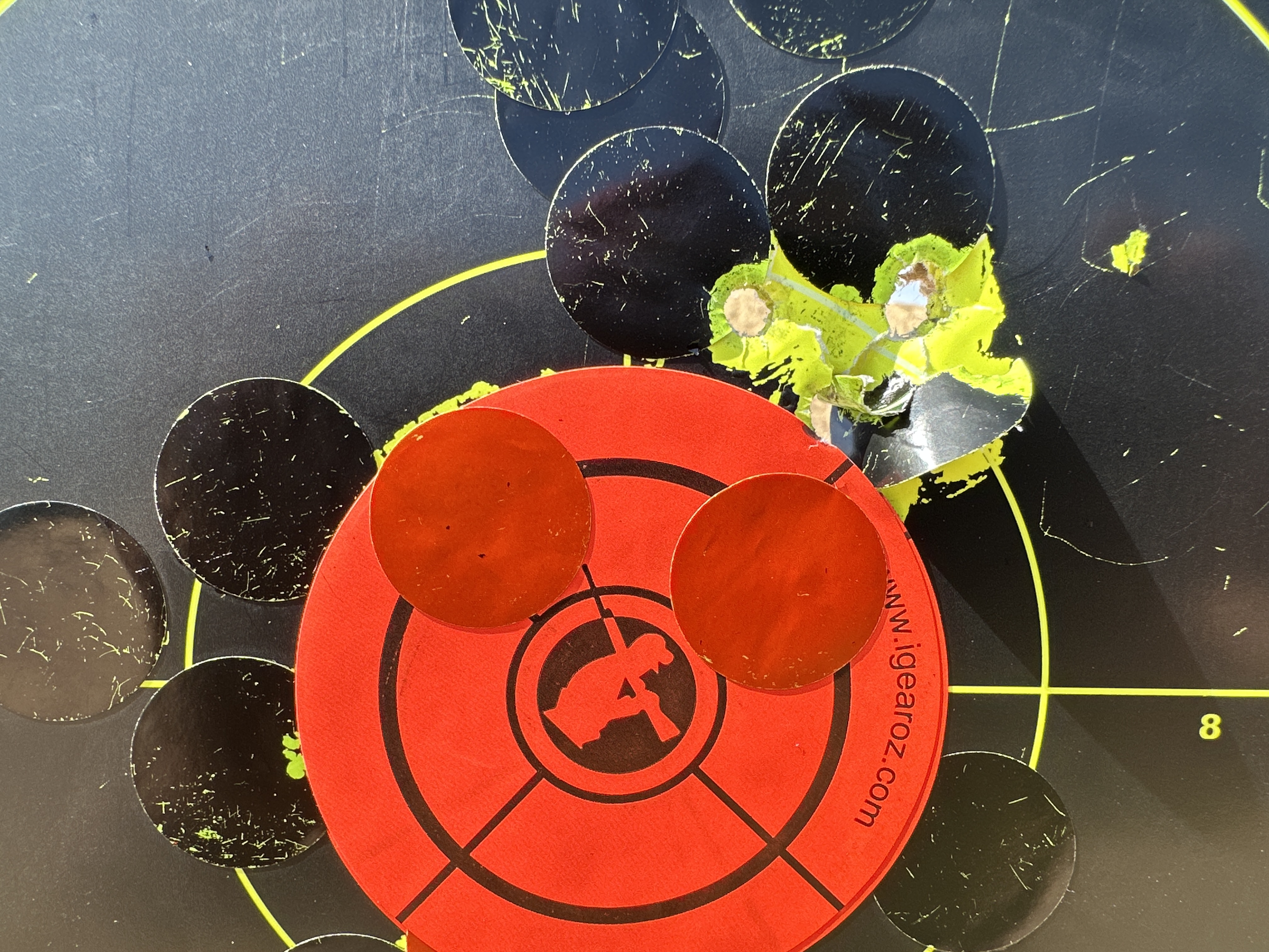

Ive been workin with 9mm and three different pistols. Two different powders, Unique and HS-6. I also have 231 which did do well in one of my 3 pistols. But Im trying to find one for all three. CZ TS 2 CZ75 B Tactical and a Springfield Ronin 1911. The 1911 isnt performing well at all. I took it to a gunsmith here locally I found to have hime check it out and see if he can get it right. I have run about 14 different loads through it with those powders and a 115 Berrys and some xtreme 124 FMJ. My CZs will shoot 1 inch groups with 5 rounds off the bags at 15 yards with the right powder. So far Unique is leading by a very little. HS-6 works well also. I havent taken any pics of targets with them but today i also took out the Marlin 336 38-55. I shot a couple of targets with it as I put a Sig Romeo red dot on it to play with. I dont really like the red to much and I may change it to a green reflex in the near future.
IMG_0605 2.JPG (2.92 MiB) Viewed 208 times
First Pic is 18 gr 5744 with a 245gr cast
Second pic is 10 gr of Unique with the same cast bullet. Both were shot at 50 yards off the bags. Both targets were 5 rounds. That 10 gr load might be a keeper :o

Fwiw, i've never got plated berrys or xtreme bullets to shoot worth a rats rear end.
For 9mm, i like clean shot and bullseye
